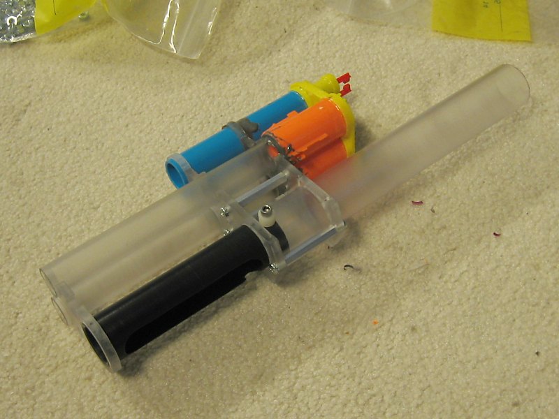

This project has been a slow process of methodical theorizing, planning, and absurd levels of craftsmanship on my part. Many parts have been made to tolerances of thousandths of an inch. Since I don't expect anyone within reason to be able to duplicate the work, I decided to be a bit less literal with the specifics of what is being done.
And no, I won't make you one.
A plan was formulated under the requested premise.
The weapon of legend can only be crafted from the finest materials. Its framework is carved from crystallized dragon tears, which are then affixed together using unrefined mithril shards.
The ram rods were hewn from orc bones, then ground and polished by elvish craftsmen over a fortnight.
With the seance to commune with the spirits of the finest swordsmiths of the Third Age successful, they have bestowed upon me through an arcane buff the abilities of their heraldry.
I have test-assembled the crafted pieces just as they had appeared in the vision that followed that bestowal.
They will later be adhered using a mixture mostly comprised of a modicum of minotaurs blood, and copious amounts of silk from the spider queen.
I searched the wilderness for the supplies needed to imbue the crossbow shell with the essence of an elder god. I then performed the ritual with great efficacy.
Likewise the shell of the splitfire was bound to the spirit of a most powerful and amicable familiar.
With the guidance of the elder god, I crafted the plunger handle from the front talon of a griffon.
I also set forth to to secure the plunger tube to the crossbow shell through abutments of crystallized dragon tears.
The trigger too is made of the same material, but only the smokiest and saltiest portions of the crystallized tears were used. The curvature of said trigger is eventually smoothed out using the finest elven tools.
To guard from the most powerful of dark magic, the breech was forged from black meteoric ore using a dwarven furnace. It provides a poignant mystical contrast next to the brutality of the orc bone.

The spider silk emulsion was applied and then left to coagulate under the light of a harvest moon. The fused parts are now inextricable.
The crossbow shell has been carved to the nines for the coupling with the splitfire.
Attachment point escutcheons are added and the fixture evaluated. The bond is confirmed to be stalwart.
A unicorn horn was cut to length and then hollowed out to make the barrel sheath.
An underbelly scale from an elder dragon was moderately adapted into a catchplate using modified arrowhead knapping techniques pioneered by the Second Age elvish archers.
The plunger rod has been extruded from refined mithril ore, and the plunger head alchemized from a seer's stone.
I bartered with a nomad to obtain this manticore stinger.
The finished article was brought to clerical authorities and bitten blessed by Baby Raptor Jesus
The work is complete. A choir of demigoddesses will sing upon its arrival in the arms of the bearer it was destined to be wielded by.
Edited by CaptainSlug, 30 March 2009 - 09:32 PM.

Many parts were finished by hand with an X-acto knife to deburr and refine edges, as well as make minute dimensional changes.

Oh yeah, I forgot to ask. I do have one question. Is it sturdy? Is it top-heavy, or pretty evened weight? How hard is it to hold on a scale of 1 to 10? Thanks in advance.
#18 CaptainSlug
  • 4,761 posts
Posted 29 March 2009 - 12:59 AM
1. Is it sturdy?
2. Is it top-heavy, or pretty evened weight?
3. How hard is it to hold on a scale of 1 to 10?
Thanks in advance.
That would be three questions. It's back to remedial math for you.
1. The innards of the crossbow are made from crystalized dragon tears. Of course it's sturdy. There isn't an ounce of duct tape, zip tie, bondo, or paint to be found on this. What you see is what was done.
If Groove runs out of darts he could just bludgeon you to death with this if he so wishes. All he would need to do afterwards is clean the blood from his weapon and move on to the next victim.
2. It's pretty well balanced. The finished blaster won't weigh much more than 2 pounds.
3. "Hard to hold" rating: -3,000
Edited by CaptainSlug, 29 March 2009 - 03:17 PM.
