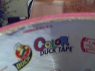

Posted 28 February 2009 - 10:39 PM
BTW: In your materials you wrote DUCK TAPE. Come on dude, DUCT TAPE.
I know, I hear some people call it Duck and others Duct, didn't know which to use so just picked one
Actually, there is a brand named "Duck Tape", which is the colored Duct Tape Brand. Pic!

DUCT tape would be a foil tape with a synthetic adhesive. It's called this because it's used on air ducts.
DUCK tape is any tape with a fabric backing and rubber adhesive. It's called this because it's waterproof... Like a duck.

Duck tape is Duct Tape it's just Harvel's (Who also makes Loctite) Trademarked name. A lot of people call it duck tape becuase they don't know that it's called duct tape.Nice work by the way clean it up with some sand paper I will be making a similar even easier setup soon.

Not meaning to jack the thread, but get this from "A History of Duct Tape", by Johnson & Johnson Company, 1942.
Adhesive tape (specifically masking tape) was invented in the 1920's by Richard Drew of Minnesota Mining and Manufacturing, Co. (3M). Duct tape (the WWII military version) was first created and manufactured in 1942 (approximate date) by the Johnson and Johnson Permacel Division. Its closest predecessor was medical tape.
The original use was to keep moisture out of the ammunition cases. Because it was waterproof, people referred to the tape as "Duck Tape." Also, the tape was made using cotton duck - similar to what was used in their cloth medical tapes. Military personnel quickly discovered that the tape was very versatile and used it to fix their guns, jeeps, aircraft, etc. After the war, the tape was used in the booming housing industry to connect heating and air conditioning duct work together.
Soon, the color was changed from Army green to silver to match the ductwork and people started to refer to duck tape as "Duct Tape." Things changed during the 1970s, when the partners at Manco, Inc. placed rolls of duct tape in shrink wrap, making it easier for retailers to stack the sticky rolls. Different grades and colors of duct tape weren´t far behind. Soon, duct tape became the most versatile tool in the household.
Here's the link. Who'd have thought.
