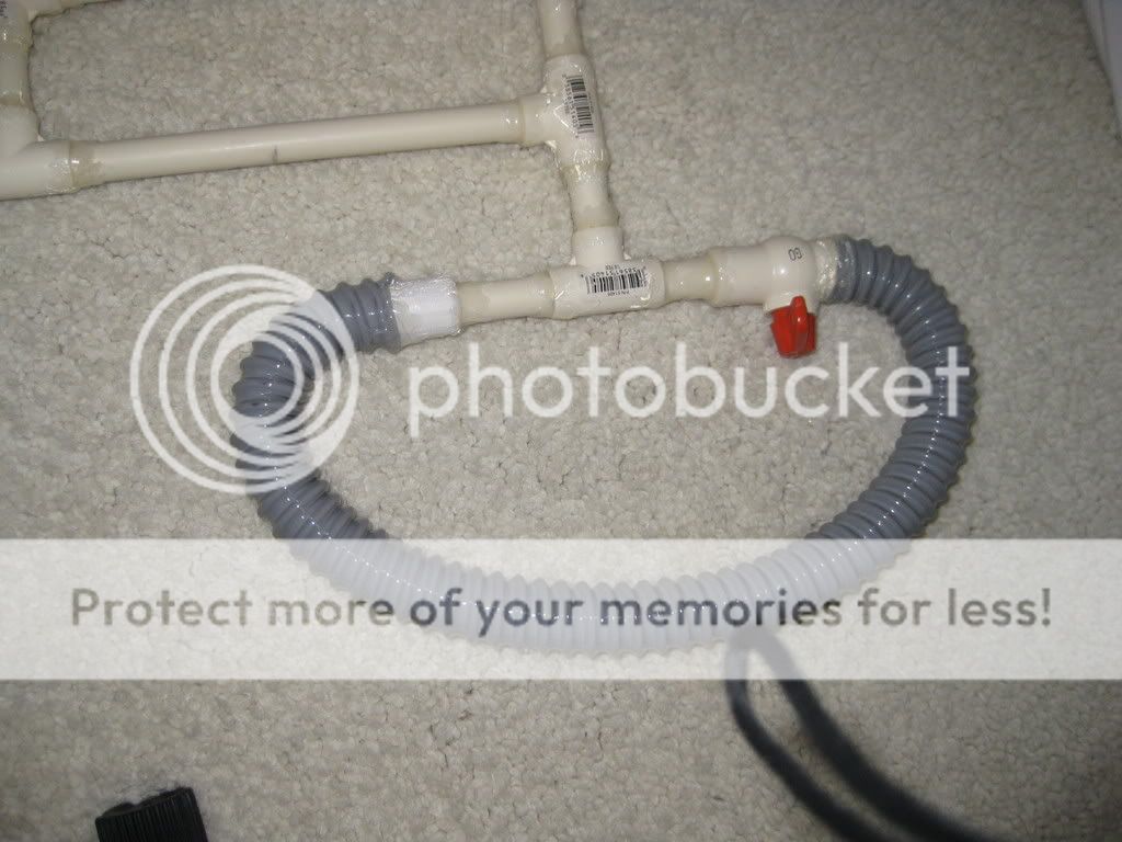

Recently, I have been trying to make a homemade nerf gun that goes over at least 50 ft. Finally, I have made it. I am not sure about the ranges but it definetly reaches 50 ft because my house is 50ft from one wall to another and it hit the wall straight. I can still increase the ranges of this gun by a lot because I used 1/2 in CPVC. If you have seen uin13's "mu", on youtube, his uses bigger pluming materials but he uses a ball valve for that size of barrel. Since I use 1/2 CPVC, I used to use a 1/2 inch ball valve. Unfortunately, the opening and closing of the ball valve was not as easy in one hand, which decreases the ranges, so I decided to go to my hardware store to check out other ball valves. Lucky for me, I found one. The ball valve that I use is for 1/2 brass both ways. It fits perfectly over the 1/2 CPVC. Unfortunately, the brass ball valve is not a 100% air tight on the 1/2 CPVC so I used some hot glue to attach and prevent any air from escaping through the cracks. This is the final product.

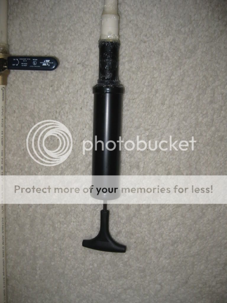

The pump that I got at the 99 cent store. Still works
This part is to just hold more air.
This ball valve is the 1/2 inch CPVC ball valve. Its just there to hold the gray piece and the CPVC together. Nothing special about it.
