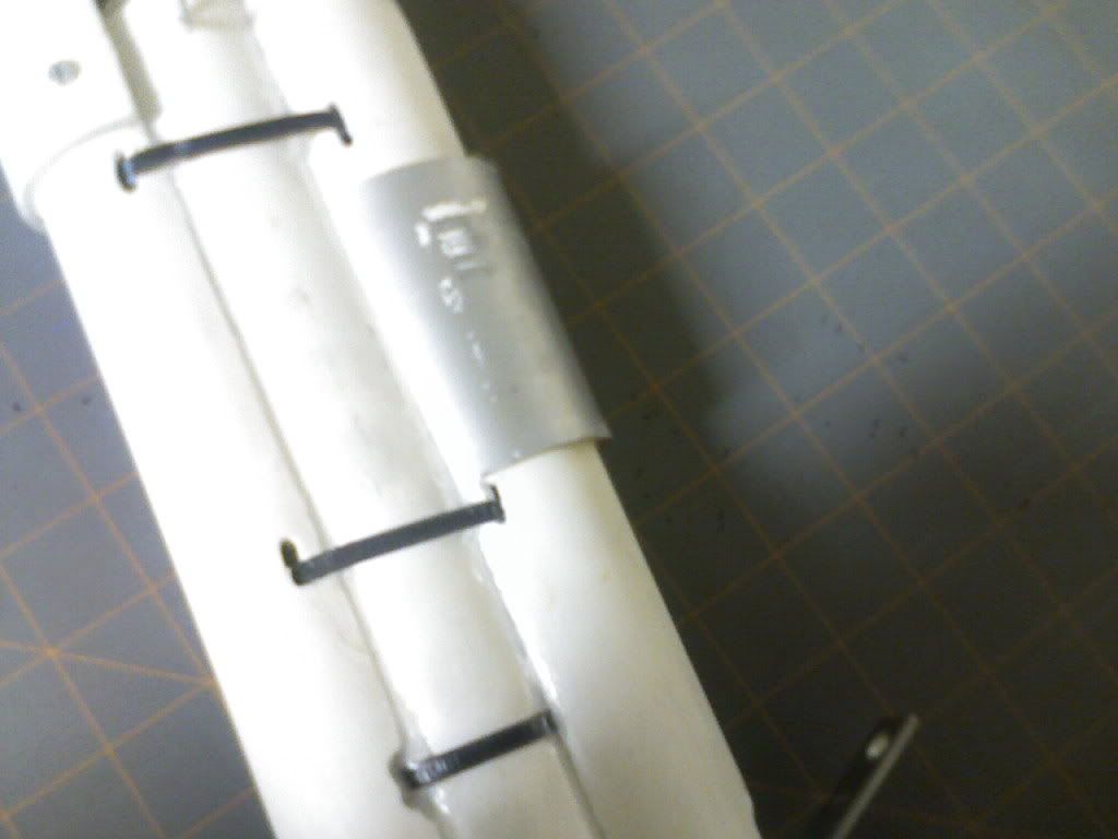

Ok, so here's what you do. You put the round part of the PVC on a gun. For this, I shall just say that SNAP type weapons are already set for this. You need atleast a someone complete section of PVC atleast as long as your coupler.
then, you make sure the PVC is on your gun. Its hard to explain, and its even harder with pictures. Really. Just wait, and you will get it in the end.

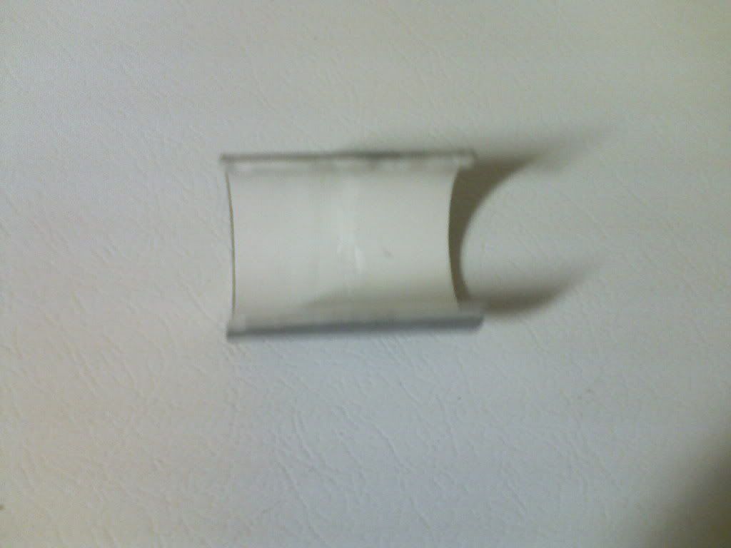

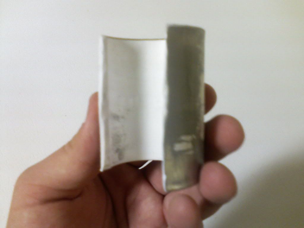

Then, you cut your coupler, so it has a strip gone from it. You should take off about a 1/4th of it. Imagine looking at the top of your coupler and dividing it like a pie in your head. Then, once you have that, shave down the ring that should run along the center of any good coupler, and shave down the sides so it can be put on to the PVC through the missing section you cut out.
It should look like this
and again
Yeah, phone camera sucks. I know.

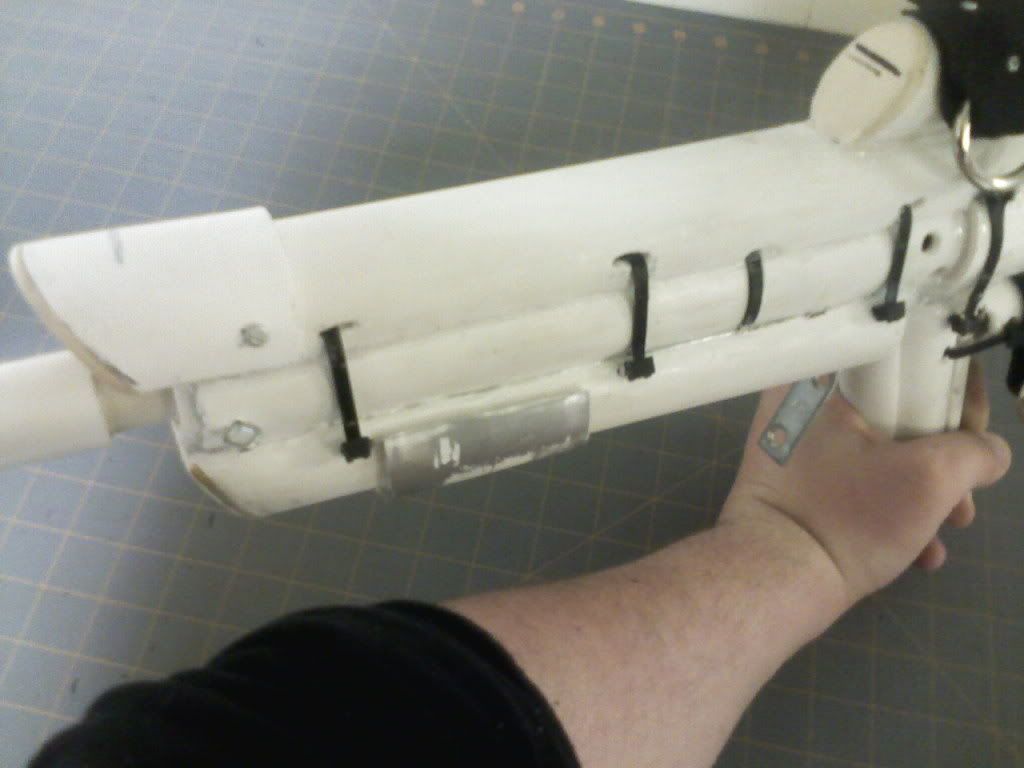

Then, you just put it on the PVC. Kinda force it on, and it should eventually click (literally and metaphorically)
How, from there you have a basic integration bracket. Mount this on anything you want to be able to slap on to your gun easily.
I would suggest securing it however. I plan to Captain Slug it and use those pins with the balls on the end so they stay firmly in place, but can still be pulled out and swapped easily.

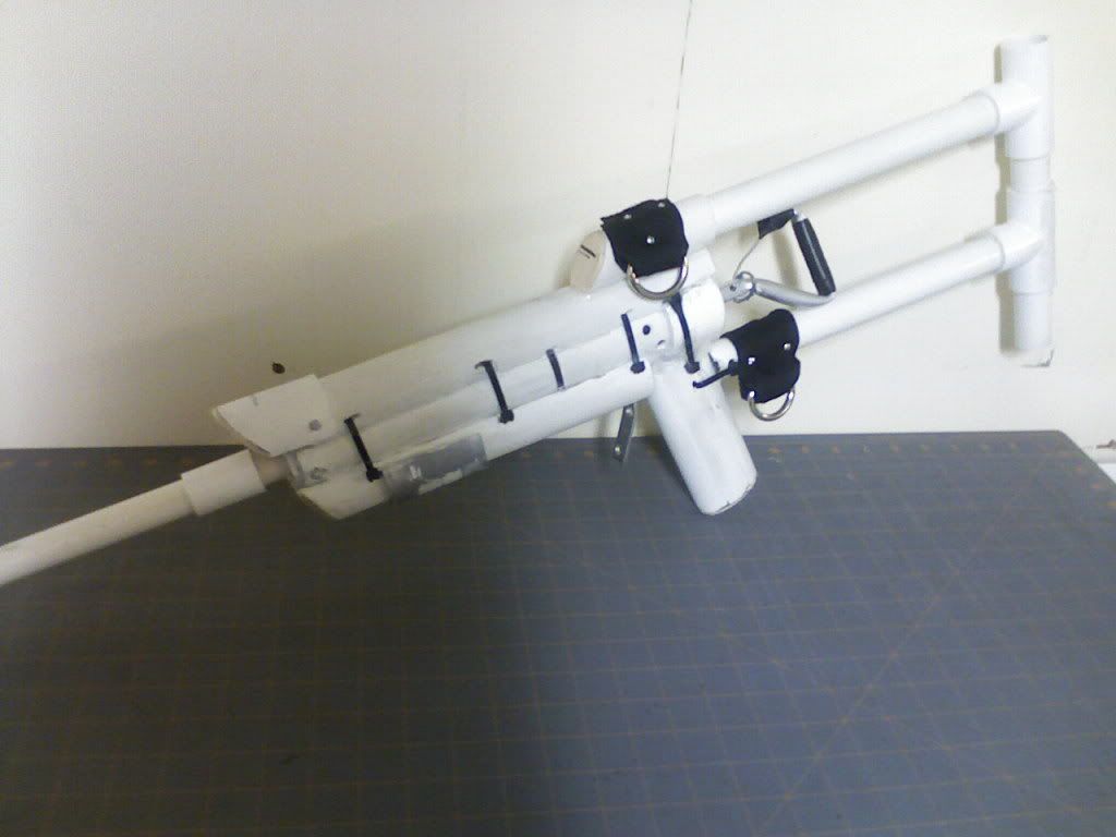

Now a shot of it on my beautiful gun... Well, soon to be beautiful (as soon as I can paint it purple that is)
and me holding it
and the beauty shot
