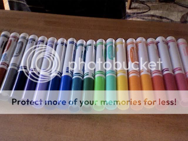

Crayolas
Yes, markers
Posted Image hooray for markers!

I've tried crayolas and rose-art barrels, and rose-art barrels are much better. They don't have the stupid little pegs inside that are almost impossible to take out without use of a dremel(i don't have a dremel). Also, they are about the same price, and they are the same length.

Rose-Art marker barrels, they work alot better than crayola for stock darts.

I use crayola barrels almost exclusively, but it's because I don't have easy access to PETG or CPVC. I also use only stock darts for now because my friends don't want to get into the stefans thing (they fear homemade darts).
For high powered air blasters I put a piece of 1/2" PVC over the crayola barrel, and it works really well most of the time.
Also, for those who have a hard time clearing out the inside of a crayola, just use a 1/2" drill bit. Wrap a rag around the non-business end then stick the cutting end in the barrel and twist away.
