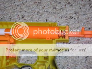

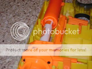

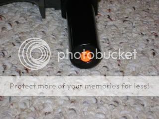

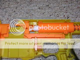

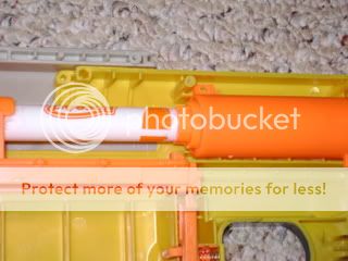

I took the cap off the end of the tube and flipped it and put it back in
fully compressed
But I'm doing it just to see if it can be done and since I had a junk recon laying around I decided to give it a try. It's kinda like a LS internals just smaller. I attached the front of the plunger tube to the barrel and I need to find a way to make an air tight seal.
When you cock the gun it will push the plunger back to the catch(and load a dart)
I still have to make the catch, rig up the trigger system and reinforce were the bolt sled joins the marker
I want to keep it mostly internal so I will probably cut off the pull loop but it seems like it will work, I guess Ill find out when i'm finished.
