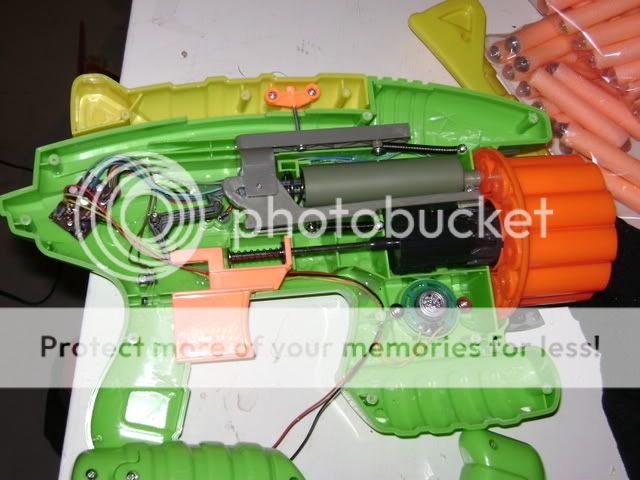

So it's a FF with a better seal?
Sort of, it is like all other spring-powered Buzz Bee blasters (with the RFR and the DS as the only exceptions). It uses the universal size plunger setup, with, for note, has a plunger tube that is slightly smaller than that of a Firefly, and yes, has a better seal. The good advantage of this universal plunger setup compared to that of several Nerf spring-powered blasters (Maverick, Scout, Longshot Frontgun, CrossFire, and Eliminator) is that it has a regular-style piston plunger which has a good plunger-to-turret seal, as well as a decently heavy-gauge spring (heavier than all the aforementioned Nerf blasters) whereas Nerf skimps out on many of the aforementioned pistols with crappy, inefficient reverse-plungers, usually lighter-gauge, weaker springs, and, in the case of the Maverick, a non-existent plunger-to-turret seal. In fact, the Tek 6 when modified to comparable level with the Maverick, outranges the Maverick.
This looks like a repackaged Tek Ten with a different shell and added useless crap, it looks a bit cheesier, but more comfortable.
