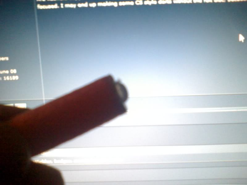

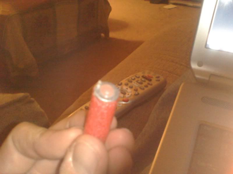

Well, badger was going to make this thread, so I decided to, since they were concerning my darts, and I wanted to come clean out and say that what I was doing was wrong, and that I'm not doing it anymore. I hope that's ok with you badger.
Ok, in prep for APOC, I was making washer darts, but didn't have the foam to put at the end. What I was doing instead, was spreading the hot glue to cover the whole washer. I did that for about 20 darts, and then simply put a dab of hot glue in the middle, leaving exposed washer. This was very wrong of me, and this is my official apology. But, as soon as badger pointed this out to me a few rounds in at APOC, I did immediately switch darts to OMC's darts before playing again. Long story short, if your using washers to weight your darts, you can't have hot glue on then end, it needs to be foam.

The felt is important to the construction of the dart. It makes the aerodynamic profile of the front of the dart uniform, it improve the seal of the dart in the barrel, It provides a minimal cushion to the tip, it gives extra surface area for the hot glue to adhere to (you fill the center of the washer with a bead of glue after sticking the washer to the felt disc), and it makes it very easy to tell if a dart is loaded into your barrel (if you use the white ones).
If you don't use the felt the risk of injury is low, but the darts will have the potential to be able to scratch cars and maybe even crack windows. Steel is a pretty unforgiving material.

Here are pictures of the darts in question:
These are the best pictures I could get since Maryann's camera needs to be charged. The dome of hot glue was coming through the center of the washer, but not covering it at all. These are potentially dangerous. A grazing shot across the face could cut you. I got shot by one of these in the face and it hurt alot more than any dart I've ever been shot with, and I kissed the pavement on Sunday. That hurt less than the dart. I would place these along the same lines as nail and screw darts...they should not be used.
