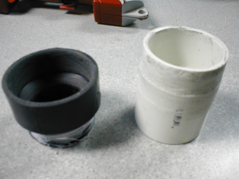

The gist of the modifications are simply to the barrel system, but honestly they are nearly useless without plugging the pump. Carbon's ball shooting barrels focused on a slightly modified 1-1/4" PVC coupler, but I didn't want to be stuck with JUST balls (sounds creepy). I wanted to be able to use EVERYTHING in the Nerf arsenal. We will begin with these six pieces.
Front and center, you should recognize the original Titan barrel cut down to just the threads. The next row back has 1-1/2" ABS pipe to female threaded adapter. On the right is a 1-1/2" to 1/2" female threads PVC reducing bushing. On the left and right, in the back row, are two 1-1/2" ABS pipe to male threaded adapter. In the middle is the 1-1/4" PVC coupler.
We'll start with the easy part. We'll take the reducer bushing, the Titan barrel, the female thread adapter, and one of the male thread adapters and prep them with ABS/PVC cleaner.
Then we add the universal pipe adhesive and combine the Titan barrel with the female threaded adapter, and the bushing with the male threaded adapter. Yay! now we have a singled titan!

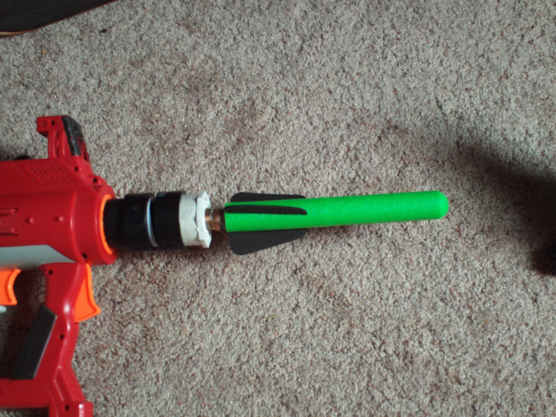

Of course, since no one actually wants to be hit by one, I've installed one of my patented combination micro/arrow barrels that I use on my triple strike and BBB. The Titan will shoot one of these green arrows 75 Feet! I'll explain how it's built later.

The next step is to sand down the 1-1/4" coupler on the outside, so that it will fit inside the remaining 1-1/2" male thread adapter. I also took the opportunity to sand down the inside lip of the coupler to allow the balls to work better. Don't remove the lip completely, just enough so that the balls will pop in and out with a little force.
Yay! Now we can shoot balls! Time to start testing!

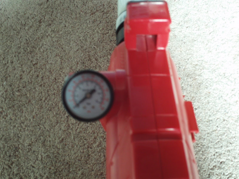

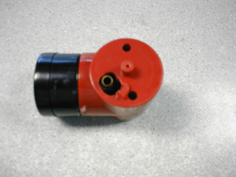

Huh... How do I keep track of how many times I've pumped the Titan? 1, 2, 3, 4.... Crap. Now the pressure gauge says full power. This will never do. So I took out the old gauge and replaced it with a REAL gauge. It's kinda tight in that little rotating head, so I had to make my own elbow adapter to go from the 1/8" NPT input on the gauge to the Titan hose.
Position it so the pipe pokes the the hose hole....
Then glue the gauge to the rim and reassemble. We end up with this...
Sorry about the blurr.

Like I said, it's not really original. But there really hasn't been much done with the balls. My arrows are surprisingly accurate, though.

My titan shredded the arrows I tried out... Nice job on it working.
What were you using as the arrow barrels?
