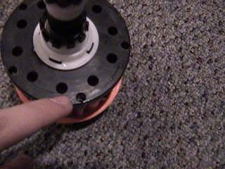

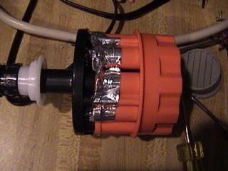

Hey guys, I haven't posted in a little bit so I assumed I should make up for it with a write-up. This Modification will teach you how to make a good seal on the turret of the DTG, how to rubber-band it (internally), and to remove the Air Restrictors. I know most (or all of this) has been done but I figured I'd post this while I was doing these mods.
Materials:
-Philips screw driver
-Hotglue (gun and sticks)
-exacto knife
-medium sized rubber band
-sealing tape

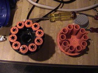

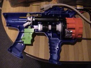

To start off, open up the gun. This internal picture is after modification.
Take out the turret and unscrew the screws on the black plate.

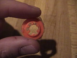

All of the AR junk should now fall out of the turret. Take each circular piece and cut off the peg and the ridges from the center, just like any other AR removal. After you do so, it should look like this. Ignore the hot glue on it, that was from a previous mod that I later Un-did.
Continue doing this to all of the circular pieces. Then put hot glue on them and glue them back on to the black section of the turret. This will create alot better of a seal.
There were a couple gaps between some of the pieces and the orange section of the turret, so I sealed them up with some tape.

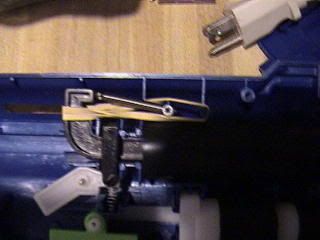

Place your turret back in place. Make sure your auto-rotating mech is in the right position. Now on to the internal banding. All you need to do is take a rubber band, double it up, and wrap it from the end of the plunger rod to the nearest screw post.
Now close up your gun and the Internals should look like they did in the first picture.
Stock ranges were about 20-25 feet.
Now, ranges are pretty good, about 45-50 feet with a DTD. Hope you enjoyed.

Is there any real disadvantage to banding the gun? I've got one on my Modular design right now, and wouldn't mind the extra range if it doesn't screw it up.
Overall, Well done.
The only disadvantage isn't really a disadvantage at all. The only negative thing the band does is make the gun just a bit louder. Other than that, it just adds maybe 5-10 feet of range to the gun.
Overall, Well done.
Actually, internal banding does have a few disadvantages. One, is that the rubber band will dry rot over time. Another is that they might shift inside the gun, making it not functional untill you take it apart and fix it.

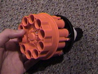

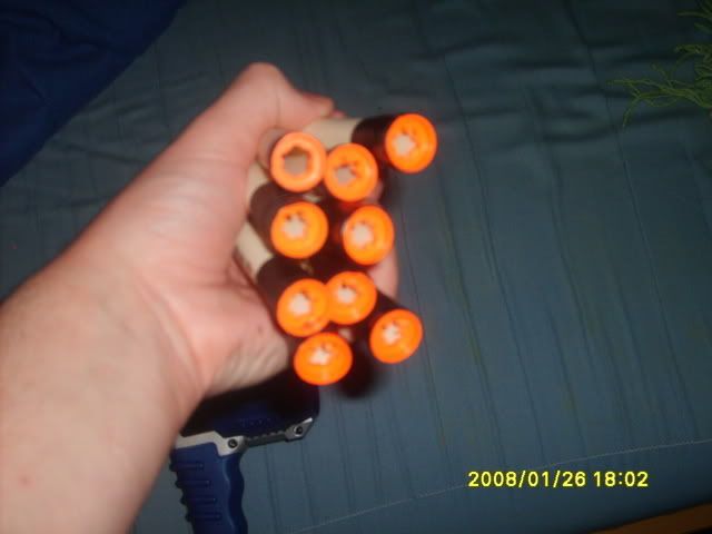

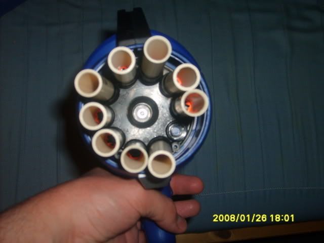

Here is the side of the DTG:
The front:
I know that the one barrel is missing. I ran out of CPVC when doing this mod.
Now with the barrels out:
If you need any more pics just ask and I'll post them.

Whoah, I really like that Dayko. So the black section of the turret acts as like one 10 shot coupler. I'm definatley going to do that with my other DTG.
P.S. Did you hot glue (Or other kind of glue) the barrels to the AR pieces before you taped them, or did you just tape them on?

I did not put any glue in but I did find out that if you leave the peg in the AR it helps the CPVC level while your taping. After you have taped them just Dremel out the peg.
