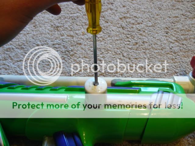

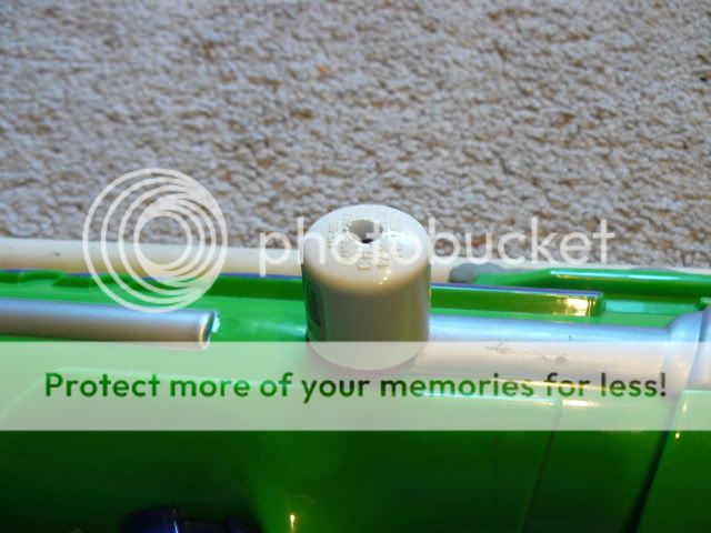

The valve is position right at the end of the ball pump's stroke in a little gap of deadspace that occurs right before the check valve. I simply drilled a hole and superglued in the tip of the barbed fitting I had put on the valve long ago. No vinyl tubing necessary. The hot glue is there for structural support, NOT for sealing.
When the blaster's all closed up, you can see how the back end of the relief valve is exposed for easy access and adjustments.

#13 TantumBull
TantumBull
  • 1,929 posts
Posted 07 July 2011 - 03:51 PM
Found an INCREDIBLY easy way to make the OPRV tamper-safe. Unless the wielder carries a screwdriver during rounds, the screw can't be adjusted.
