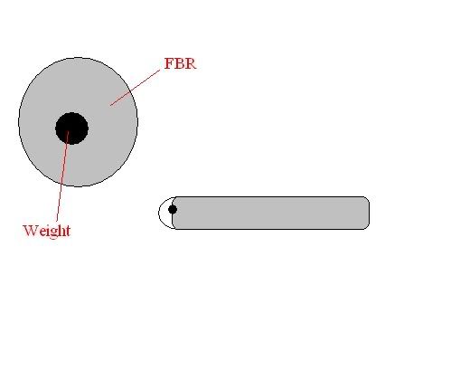

Here's a quick paint picture of the off center weight.
I don't know if SpaceCAD will measure stability that way... If that makes sense...
I use a single 3/0 split shot weight (non-removable, doesn't have those wings). Since the package doesn't show the weight of a single one, I can't really compare it too well to the triple BB set up. I also don't have any accurate scales that measure things that small.
How's the stability for a dart 1.5" in length? That's what my darts are currently at.

No, I'm afraid SpaceCAD can't do an off-center weight like that, but, considering that the position of the weight could be 360 degrees at a particular radius, I'm sure if you found a way to calculate its weight from any given point, you might get your results. I may be past Calc 3 but I can't really think of a way to concretely get an answer for you.
Oh yeah. If you're talking about my "proper made stefans," a 1.5 inch dart will be at -0.44 calipers. That's only about .07 worse than the one-inch.
